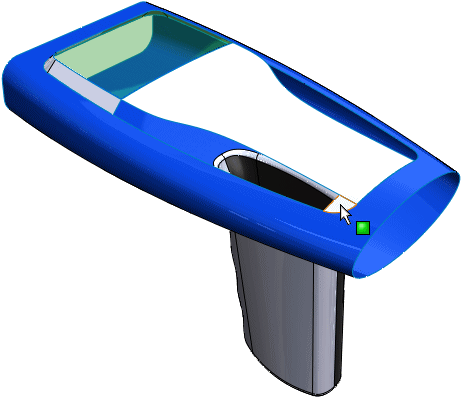

  1. Roll the model forward to ControlsCornerFill-Surface-Fill3 .
  2. Select the face shown and click Edit Feature .

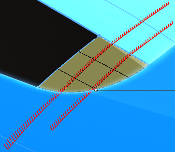

  3. In the PropertyManager, under Curvature Display, select Curvature combs and Direction 1. Clear Direction 2.
  4. Set the Scale to 40.
    The combs indicate a smooth continuous curvature across adjacent faces.
