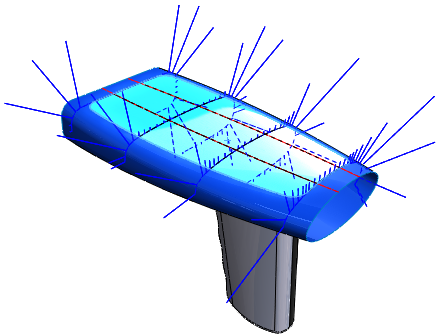

The Surface Curvature Combs tool shows curvature combs at various locations on the surface of the model.
To view surface curvature combs:
  1. Open install_dir\samples\whatsnew\parts\scanner.sldprt.
  2. Roll the model back to Controls-Split Line .
  3. Select the face shown.
  4. Click View > Display > Surface Curvature Combs.
    The combs indicate a smooth continuous curvature across adjacent faces.
  5. Click .
    The curvature combs are displayed on the surface for use in further editing.
    To stop displaying curvature combs, click View > Display > Surface Curvature Combs.
