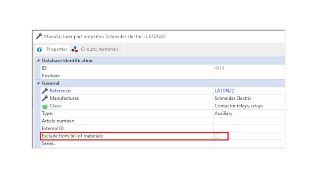

You can use the Exclude from bill of
materials property in the Manufacturer part
properties dialog box to show or hide components in a BOM. The property
propagates into assemblies and 3D parts.
You can use a filter in the report
configuration to hide or show these components.
