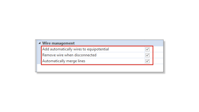

You have more options to manage wires in the project.
These options are available in the
General tab of the project configuration.
You can:
- Draw lines without wires (equipotentials).
- Remove the wire when you disconnect it from a symbol.
- Merge the wires when you delete a connected symbol.
To process wires in legacy projects, select all these options.
