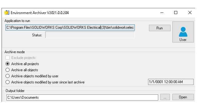

You can archive the SOLIDWORKS Electrical projects and environment by
running EwEnvironmentArchiver.exe.
The
EwEnvironmentArchiver.exe file runs on
Windows® 10. You can schedule the archive process
using Windows Task Scheduler.
To start the archiver application, do one of the following:
- From SOLIDWORKS Electrical, run the EwEnvironmentArchiver.exe file.
- From the Windows Start
menu, search for EwEnvironmentArchiver.exe
and run it.
