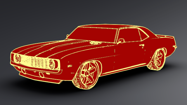

Toon Shading
Toon shading mimics the style of a comic book or cartoon and provides a characteristic paper-like texture. Toon shading is available only with Visualize Professional.
To add Toon shading:
  1. In the Palette, on the Cameras tab, select the Filters subtab.
    Because Toon shading is added as a camera filter, your primary appearance assignments remain unchanged.
  2. Under Toon, select Enable Toon and specify parameters:
    Toon Presets Provides a list of predefined toon profiles that you can select.
    Black Edges
    White on Black
    Black on White
    Ambient Occlusion
    Custom
    Edge Color Changes the color of the outlines. Click the color box to open the Color Picker dialog box.
    Shading Style Select a style:
    Normal
    Toon Shaded
    Toon Detail
    Color Override
    Plain Shaded
You can save the camera .svcm file, which contains the Toon shading parameters, and use it in other Visualize projects or share it with other users.
