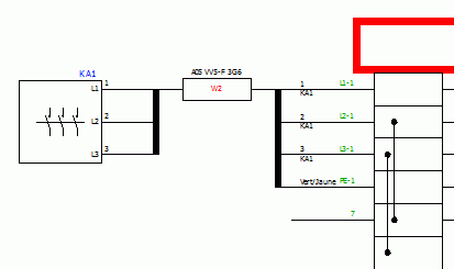

The cable is represented in the terminal strip drawing by a customizable basic symbol (Cable label), composed of a rectangle, text displaying the cable location, text displaying the cable reference, and two lines.
The first two zones of the lower part of the dialog box display the text parameters (such as the font, the color or the size) as well as their positioning parameters.
Text is positioned in relation to the intersection point of the rectangle's two diagonals. The X offset and Y offset parameters allow you to control the distance between the text and this point.
The third zone of the lower part (Cable label) allows you to select a symbol that is positioned on the base point (intersection of the rectangle's two diagonals). Three icons are available to Add a new symbol, Remove the symbol displayed and Edit the symbol displayed.
Please note: this symbol is added to the basic symbol. If you would like to display your own symbol, certain parameters should be set in order to hide the basic symbol (set its dimensions to 0 and hide the texts).
General
Cable position: Allows you to control the position of the symbol marking the cable label in relation to the thick line grouping together the cable cores. The Top parameter corresponds to the first cable core, the Center parameter positions the symbol in the center of the thick line and the Bottom parameter places the symbol on the last cable core.
Minimum distance before label: Defines the length (A) of the line separating the rectangle of the cable label and the thick line of the cable.
Label width: Defines the width (B) of the rectangle of the cable label.
Label height: Defines the height (C) of the rectangle of the cable label.
Maximum distance after label: Defines the length (D) of the line placed at the other end of the rectangle.
Minimum number of cable cores before next drawing: This parameter allows you to define the number of cable cores that can be drawn on the drawing before it reaches the limit zone and generates an automatic page break.
For example, if you enter 0 in this parameter, the cable will be drawn on another drawing if the software is not able to place all of this cable's cores on the drawing.
If you enter 3 in this parameter, the software will place three cable cores on this drawing (if it is able to do so, i.e. without exceeding the drawing limit) and will draw the other cores on another drawing. If there is only space to draw two terminals on the drawing, it will place all of the cable's cores on a new drawing.
Distance between cables: This parameter allows you to define the distance between the two thick lines representing the cables (E).
Cable line width: This parameter allows you to define the width of the lines grouping the cable cores. If you enter 0, the width is not applied.
