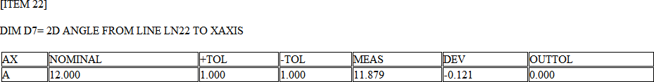

The simplest format is to identify the item number and not have any specification or
measurement notes to add. This format without an axis identification can only be used if
there is only one axis reported. For example:
![](gof1602008350652.image)
Resulting PPAP:
![](oia1602009882146.image)

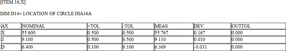

When there is more than one axis reported, you must identify the axis in
the second location. For example:
![](rqo1602010199296.image)
Resulting PPAP:
![](abm1602010341393.image)

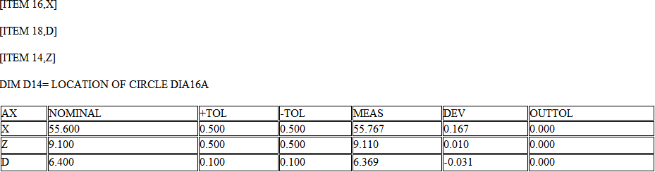

If you report three items and you do not include any specification or
measurement notes, give each item identification its own line. For example:
![](kun1602010532360.image)
Resulting PPAP:
