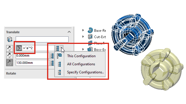

Dimension Support for the Move/Copy Body Command
When you use the Move/Copy Body command, you can control the Translate and Rotate values with equations. You can add these equations to a design table and control them there. You can double-click the dimensions in the graphics area and specify them using the Modify dialog box.
Under Rotate, you can select Euler's angular rotation and specify values for Yaw (side-to-side), Pitch (up-down), and Roll (twist). This method delivers the same resulting rotation regardless of the order in which you specify these values.
If models have configurations, you can specify the configurations to which the dimensions apply for Translate and for Rotate when you select Euler method of angular dimensions.
