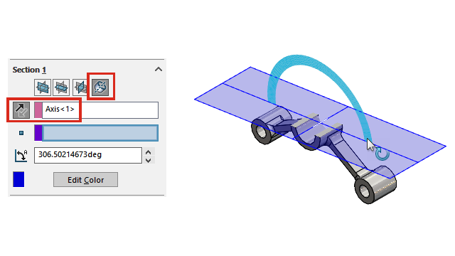

You can define a section view through an axis without constraining it to
a secondary point, such as a vertex. Previously, a secondary selection was mandatory.
When you click Plane
about axis
, you can click Reverse Section Direction
to flip the section view across the
created plane.
