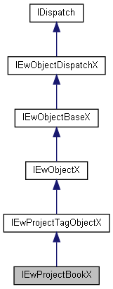

Inheritance diagram for IEwProjectBookX:
Inheritance graph
