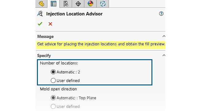

Injection Location Advisor
The Injection Location Advisor can iteratively determine an optimal number of injection locations (maximum of 10) to fill a cavity.
The default for Number of locations is Automatic, which activates the iterative approach for finding an optimal number of injection locations. To specify a custom number of injection locations, select User defined.
