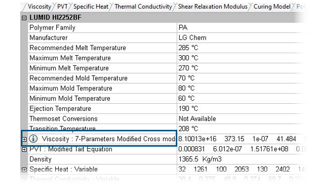

Fill and Pack simulations support materials with pressure-dependent viscosity.
Materials that have pressure-dependent viscosity are listed in the Plastics Materials Database with an information icon .
Accounting for pressure-dependent viscosity is important for parts that contain long flow lengths or very thin walls, or for cases where you need high injection pressures.
