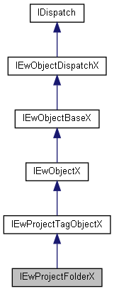

IEwProjectFolderX Interface Reference
Use this interface to manage folder inside a project. More...
Inheritance diagram for IEwProjectFolderX:
Inheritance graph
