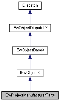

IEwProjectManufacturerPartX Interface Reference
Use this interface to manage manufacturer part inside a project. More...
Inheritance diagram for IEwProjectManufacturerPartX:
Inheritance graph
