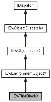

IEwTitleBlockX Interface Reference
Use this interface to manage a definition of a title block. More...
Inheritance diagram for IEwTitleBlockX:
Inheritance graph
