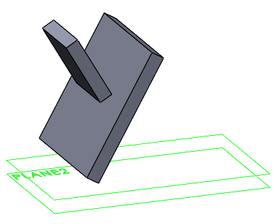

Drop Test of Disjointed Parts
Two disjointed bodies approach a rigid wall at 50 m/sec. After the first body hits the wall, the second body continues to move towards the wall under the effect of gravity until it hits the first body.
In this lesson, you learn the following:
  • Setting up the drop test study and result options
  • Specifying contact between the components
  • Viewing the stress and displacement results
