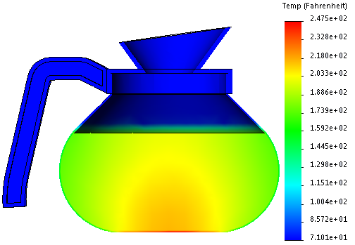

Generating a Section Plot of the Temperature
You view temperature at the last time step using a section plot.
To generate a section plot:
  1. In the Simulation study tree, right-click Thermal (-Temperature-) and select Section Clipping .
  2. Select the Right plane from the flyout FeatureManager design tree for Reference entity under Section 1.
  3. Under Options, clear Show section plane.
  4. Click .
  5. Save your work and close the assembly document.
