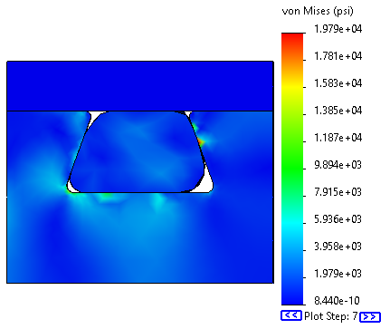

Animating the Displacement Plot and Plotting von Mises Stresses To animate the displacement plot, right-click anywhere in the graphics area and select Animate. Click this animation to play it or to reset it. In the Animation PropertyManager: Under Basics, click to stop the animation. Click . To plot von Mises stresses, in the Simulation study tree, double-click the Stress1 icon in the Results folder. Congratulations! You have completed this lesson. Parent topicNonlinear Contact Analysis of an O-Ring Previous topic Viewing Results
