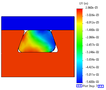

Viewing Results To plot Y displacement: In the Simulation study tree, right-click the Results folder and select Define Displacement Plot. In the PropertyManager: Under Display, make sure that Component is set to UY: Y displacement. Under Display, set Units to in. The last solution step number appears in the Plot Step box by default. Under Deformed shape, click True scale. Click . The following plot is generated. Parent topicNonlinear Contact Analysis of an O-Ring Previous topic Meshing the Model and Running the Analysis Next topic Animating the Displacement Plot and Plotting von Mises Stresses
