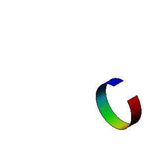

  1. While the resultant displacement plot is displayed, right-click the plot, and select Animate.
    Click this animation to play it or to reset it.
  2. In the PropertyManager:
    1. Click Stop to stop the animation.
    2. Click PM_OK.gif.
