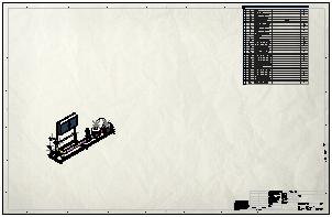

Adding a BOM Now add a BOM. Click Bill of Materials (Table toolbar) or Insert > Tables > Bill of Materials. In the PropertyManager: Under BOM Type, select Parts only. Click . In the graphics area, click to place the BOM. Zoom to the BOM table. Notice there is no information about pipe lengths. Parent topicRouting - Pipes and Tubes Previous topic Inserting a View Next topic Completing the BOM
