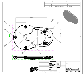

Modifying the Section View The section view is aligned in the direction of the cut, as indicated by the arrows of the section line. The arrows of the section line should point down. When a drawing view is out of date, it is marked with a crosshatch pattern. If it is out of date, do one of the following:Select the section view and click Update View (Drawing tab) to update the section view only. Click Rebuild to rebuild the entire drawing. Click . Parent topicAdvanced Drawings Overview Previous topic Creating a Section View Next topic Dimensioning the Section View
