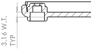

Dimensioning the Section View Click Smart Dimension (Dimensions/Relations toolbar). In the section view, select the two lines as shown. Click to place the dimension to the left of the view. In the PropertyManager: Under Dimension Text, type the following after <DIM>:W.T.TYP Click Left Justify . Click in the graphics area to finish the text. Parent topicAdvanced Drawings Overview Previous topic Modifying the Section View Next topic Completing the Section View Dimensions
