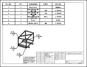

Adding a Column to the Cut List
Add a new column to the cut list for the custom property PARTNUMBER that you added in the part document.
  1. Right click in the LENGTH column, and select Insert > Column Right.
  2. In the PropertyManager, under Column Properties:
    1. Select Cut list item property.
    2. Select PARTNUMBER in Custom property.
    3. Type PART NO. for Title.
  3. Click .
    A new column is added to the cut list, listing the part numbers you defined for the cut list items in the part document.
    To adjust the column width, drag the column border.
  4. Select the PART NO. column and use the pop-up toolbar to clear Use Document Font and change the font height to 12.
  5. Right-click in the table and select Formatting > Entire Table.
  6. In the dialog box, set Column Width to 40 and Row Height to 10, then click OK.
    If your file is using different units, these values might not work. Adjust them to a reasonable value.
