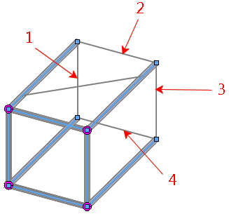

Now add a group for the back of the box. Instead of mitered corners like the front of the box, make the two horizontal bodies butt up against the sides of the vertical bodies, and leave the ends of the vertical bodies open at the top and bottom.
  1. In the graphics area, right-click and select Create New Group.
  2. Select each edge, in the order shown, for Path segments.
    The results of selecting End Butt1 in the next step can vary depending on the order in which you select the segments. For consistent results in this lesson, select the segments in the order shown.
  3. Under Settings, select Apply corner treatment and click End Butt1 .
