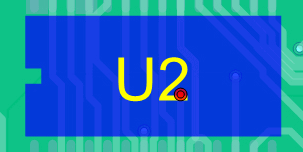

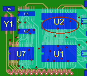

    There are 37 vias on the board. There are three vias through the U2 component of the board.
  2. Right-click the first STANDARDVIA_EXAMPLE Vias 16x16.png via and click Properties.
    The Via Properties pane appears.

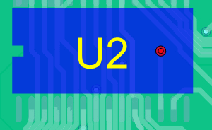

  3. For Via Diameter, enter 1.0 click PM_OK.gif.
  4. Repeat steps 2 and 3 for the other two STANDARDVIA_EXAMPLE Vias 16x16.png vias.
