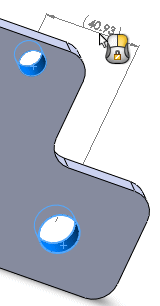

In the modeling environment, you can set horizontal and vertical linear dimensions during dimension creation.
You can move the pointer to set horizontal and vertical linear dimensions during dimension creation within the modeling environment. This is similar to creating horizontal and vertical dimensions in drawings and sketches.
