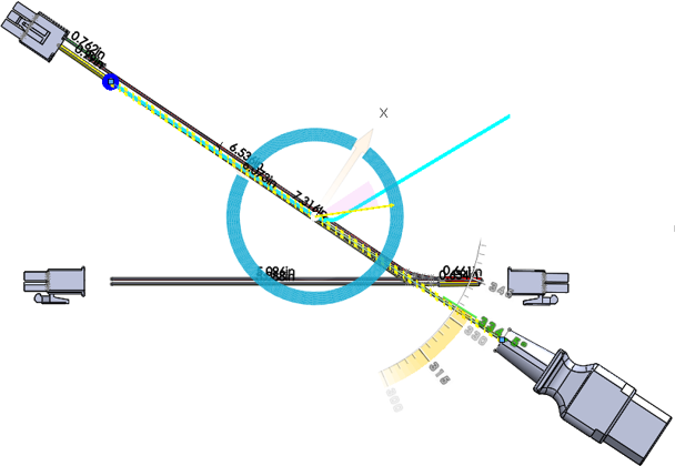

Enhancements in Edit Flattened Route
You can edit complex manufacturing-style flattened routes with the enhanced edit tools in the Edit Flattened Route tool.
You can also access Edit Flattened Route from the shortcut menu of the flattened configuration in the FeatureManager design tree.
The following aspects are enhanced:
  • Temporary graphics.
  • Manipulator to change bend angle and bend radius.
  • Fixed point selection to determine which side of the route segment is to be edited.
