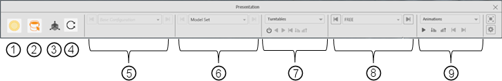

| 1 |
Render Selection |
Displays the control that is currently selected on the main toolbar. |
| 2 |
Selection Tool |
| 3 |
Object Manipulation Tools |
| 4 |
Camera Tools |
| 5 |
Base Configuration Navigator |
Lets you select a specific configuration, and switch
consecutively between existing configurations (previous, next). You cannot create new configurations.
| 6 |
Model Set Navigator |
Lets you select a specific Model Set, and switch
consecutively between existing Model Sets (previous, next).
You cannot create a new model set.
| 7 |
Turntable Navigator |
Lets you take the following actions on the selected model or
models in the combo box:- Enable/Disable
- Play/Pause
- Faster/Slower
- Reverse rotation
- Reset
| 8 |
Camera Navigator |
Lets you select a specific Camera and switch consecutively
between existing Cameras (previous, next). You cannot create a new camera.
| 9 |
Animation Navigator |
Lets you take the following actions on the current selections
in the combo box:- Play/Pause
- Faster/Slower
- Previous/Next frame
