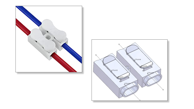

A complex splice has multiple circuits to which you connect wires
or cable cores.
To connect wires or cable cores to a
complex splice, you must insert the CPoints, and the RPoints if the wire crosses the
splice, corresponding to the different circuits.
You can use complex splices in a manual
routing or using the From-To list.
The complex splices are not supported in
the flattening.
