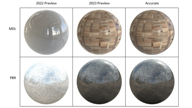

In the Preview render mode,
display
has improved
for
Physically Based Rendering (PBR) materials, as well as NVIDIA® Material Definition Language
(MDL)
appearances, and AxF™
appearances.
Improvements include the display of:
- Physically based rendering appearances for better render
consistency.
- Materials that use texture distilling in the background, such as
MDL and AxF appearances.
