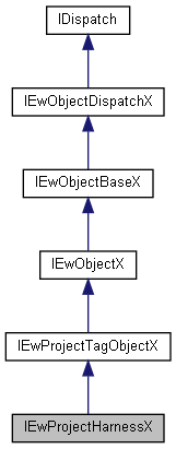

Use this interface to manage the Harness inside a project. More...
Get an array of IDs containing all the objects which belong to the harness.
Get all the cable object interfaces of the current Harness, IEwProjectCableX.
Get the manufacturer part object interfaces of the components added to the Harness (IEwProjectManufacturerPartX).
Get the manufacturer part object interfaces of the current Harness (IEwProjectManufacturerPartX).
Get all the wire object interfaces of the current Harness (IEwProjectWireX).
Remove all objects from the harness.
Remove list of object ids from current harness.
