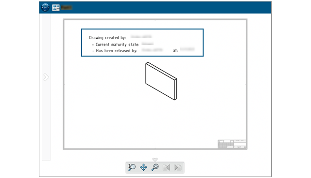

Viewing the Drawing Annotations (2024 FD02)
You can now view the annotations for the extended attributes of a drawing in 3DPlay or 3DMarkup.
Benefits: You can track the lifecycle of a drawing by viewing its properties in the preview.
In earlier releases, when you changed the maturity state of a drawing to Released you were able to view its properties only through the Properties page. Now, if you view the drawing in 3DPlay or 3DMarkup along with the PLM properties, the extended properties are also visible.
The supported extended attributes are:
  • $PLMPRP.ea_releaseddate.1
  • $PLMPRP.ea_releasedby.1
  • $PLMPRP.ea_createdby
The annotations for the extended attributes are visible only if the drawing is released using the Change Maturity command in the Collaborative Lifecycle app.
