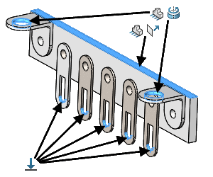

Opening the Part Browse to drive letter:\Users\Public\Public Documents\SOLIDWORKS\SOLIDWORKS version\samples\Simulation Examples\Design Scenarios\Hanger.SLDPRT) and open the file. The Partial study includes: A static study Alloy steel for the material An On Cylindrical Face fixture and an On Flat Face fixture as shown Vertical forces applied on the central hanger and on the four side hangers Parent topicEvaluating Designs for Changing Loads and Model Dimensions Next topic Defining Parameters
