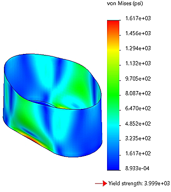

Viewing Results on Bottom Faces of the Model In the Simulation study tree, right-click the Results folder and select Define Stress Plot . In the PropertyManager, under Display: Select psi in Units . Select Bottom in Shell face . Under Property: Select Include title text and type a title for the plot, for example, von Mises Stress on the Bottom Faces of the Tank. Select Associate plot with name view orientation, then select *Isometric from the menu. Click .Rename this plot to Bottom von Mises. Note that the stresses on top and bottom faces of the model are slightly different. Parent topic Analysis of a Fuel Storage Tank Previous topic Viewing Results Next topic Customizing Result Plots
