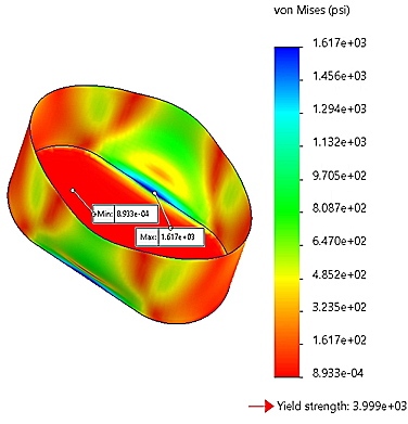

You can customize your result plots.
In the Simulation study tree, right-click Bottom von Mises in the Results
folder and select Chart Options or double-click the plot legend.
In the PropertyManager under Display Options, select Show min annotation and Show max annotation.
Annotations for the minimum and maximum von Mises stress appear on the plot.
- Under Position/Format, click
to vertically center the plot legend on the right side of the plot window.
- Under Color Options, select Flip.
After flipping the default color map, areas with low von Mises stress are shown in red and areas with high von Mises stress are shown in blue.
- Click
