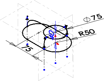

3D Sketching with Planes
Create an industrial design model using a single 3D sketch and 3D sketch planes.
In this lesson you learn to:
  • Open a 3D sketch on a selected plane
  • Add 3D sketch planes using references
  • Use arcs in a 3D sketch
  • Add relations between arcs, splines, and construction lines
  • Create a surface loft from a single 3D sketch using contour select
Single sketch with 3D Sketch Planes
Finished Model
