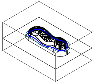

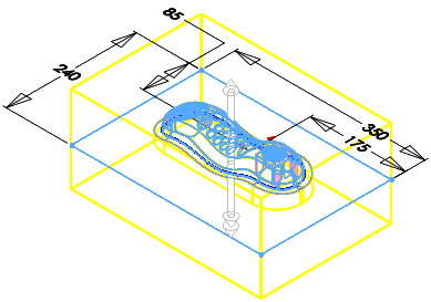

Completing the Tooling Split In the PropertyManager, the following appears: Shut-Off Surface1[1] under Core Shut-Off Surface1[2] under Cavity Parting Surface1 under Parting Surface Click Isometric (Standard Views toolbar). Under Block Size: Set Depth in Direction 1 to 90. Set Depth in Direction 2 to 70. Select Interlock surface. Set Draft Angle to 3. Click Wireframe (View toolbar). Click to create the core and cavity blocks. Parent topicMolds Design Introduction Previous topic Applying the Tooling Split Next topic Moving the Core from the Cavity
