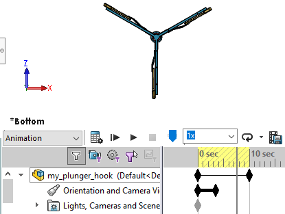

You can prevent view key creation when creating an animation. Next, you disable view key creation and set time-based views.
Right-click Orientation and Camera
Views
(MotionManager tree), and click Disable Playback of View Keys
View key playback is now enabled. The
Views icon changes to
and
Keys appears cleared
Views
(MotionManager tree), and click Disable View Key Creation
When you select
Disable View Key
Creation, the button appears selected
in the
Orientation and Camera Views
command list.
Drag the time bar to 0 seconds and click Top View
(Standard Views
toolbar).
Drag the time bar to 10 seconds and click
Bottom View
(Standard Views
toolbar).
The view keys for the new views are not created in the
timeline.
Click the Playback Mode
flyout (MotionManager
toolbar) and click Playback Mode:
Reciprocate
- Click Play from Start
(MotionManager toolbar).The views do not appear in the animation because you disabled the view keys.
Click Stop
You can repeat steps 1 through 7 to observe the animation
when you enable view key creation.
