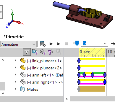

Next, you hide the arm left.sldprt and arm right.sldprt components at the end of the animation.
Right-click arm left in
the FeatureManager design tree and click Hide
Repeat step 1 for the arm
right component.
The magenta component changebars indicate appearance
changes.
- Click Play from Start
(MotionManager toolbar). You can play the animation rather than calculating it because the appearance
changes do not affect the calculated motion.
The handle disappears at the end of the animation.
