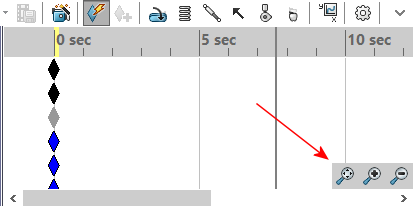

Zooming the Timeline and Setting the Start Position
Next, you zoom in on the timeline and set the initial position for the animation.
  1. Click the zoom tools and (lower-right corner of the MotionManager) until the timeline displays approximately 10 seconds.
    The vertical gray line is the time bar.

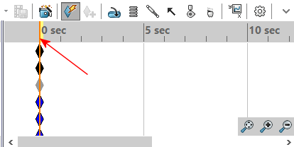

  2. Click the timeline at 0 sec to move the time bar to the start time.
    Moving the timeline to 0 seconds specifies the initial starting position of the model for the animation.
