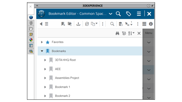

You can save data to the 3DEXPERIENCE platform even if bookmarks are frozen, completed, archived, or deleted. If an assigned bookmark fails, a message indicates that the data is not bookmarked.
Benefits: Save operations run even when bookmarks are frozen, completed, archived, or deleted.
After saving, you can use the Bookmark Editor to manually resolve issues and assign bookmarks.
