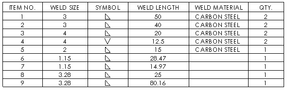

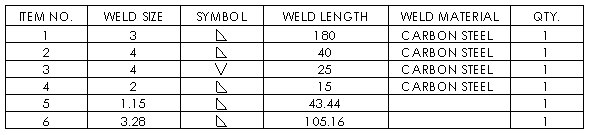

In this example, when weld types are combined, rows 1 and 2, rows 6 and 7, and rows 8 and 9 are combined. Rows 3 and 4 are not combined because their weld types are different. For example, when rows 1 and 2 are combined, the weld length is 180 (2x50 + 2x40) and the quantity is 1.
Not Combined (Welds are grouped by type, size, and length.)
Combined (Welds are grouped by type and size.)
