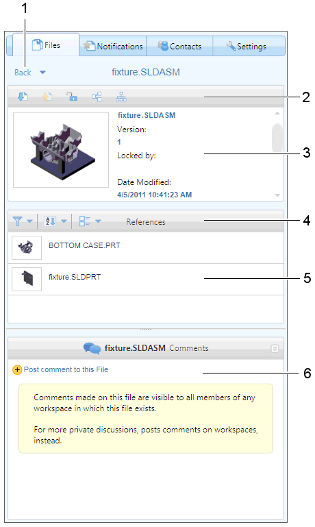

You can view detailed information about SolidWorks files. You can also perform actions on files from the File Details window.
To view detailed information about a file, click a file name or preview thumbnail from the files list in a workspace. The File Details window provides file information as well as information about ownership, version number, and to which workspaces the file is currently shared.
File Details UI
1 Back button—Click to return to the previous screen. Click Back button options to show skip more than one previously visited screen.
2 File details toolbar—Upload, download, lock/unlock, share, and open file in Tree View window.
3 File details area—Lists file details and a large preview thumbnail of the selected file.
4 Referenced files toolbar—Filter, sort, or change the way referenced files are displayed in the window.
5 Referenced files list—Displays any files referenced by the selected file.
6 Comments panel—View, add, and manage comments related to the selected file.
Any referenced files will appear in a separate panel, and you can view information on these files in the same way, by double-clicking on the file name or preview thumbnail.
