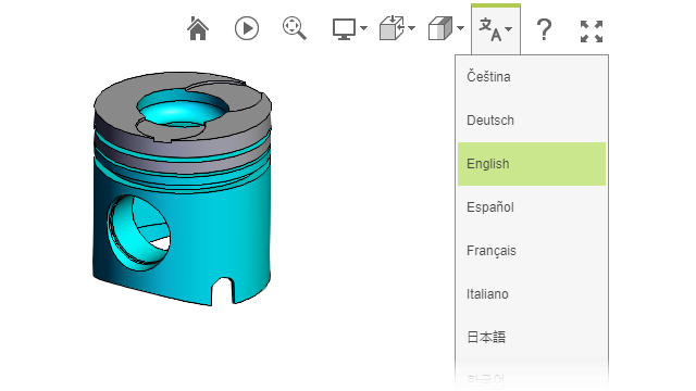

![](bcr1648839340735.image)
(Available in
eDrawings Professional.) When you save a file as eDrawings Web HTML, then open the
.html file, you can select a language to
display the user interface in the localized language. The file itself retains its native
language.
This is helpful if you share the file with a user who
speaks a different language.
To use a localized version of eDrawings Web
HTML:
- In eDrawings, click .
- In the dialog box, in Save as
type, select eDrawings Web HTML Files
(*.html).
- Double-click the file that you saved.
- In eDrawings Web HTML, click Languages
and select a language.
