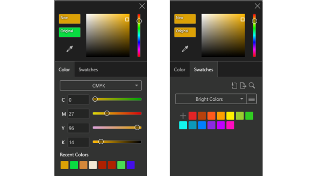

In the
Color
Picker, you have more ways to define colors, you can display recently
used colors, and you can import and export color swatch palettes.
The
Color
Picker includes two tabs:
Color
and
Swatches.
On
the
Color
tab you can:
- Define color codes including:
- CMYK, which lets
you modify color through CMYK components.
- HEX, which lets
you view and edit the hexadecimal code.
- Access
the
most recently used colors in Recent
Colors.
On
the
Swatches
tab you can:
- Click Import
Swatch
Palette
to import
existing
color swatch palettes from:
- SOLIDWORKS Palettes (.sldclr)
- ACO files (.aco)
- SVG files (.svg)
- HTML files
- Click Export
Swatch
Palette
to export color swatch
palettes from
SOLIDWORKS
Visualize and use them in SOLIDWORKS.
- Select preset swatch palette libraries such as Bright, Pastel, and
Grayscale.
- Manage existing or new swatch palettes by adding, naming, duplicating,
deleting, and
locking
them.
