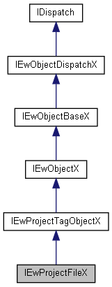

IEwProjectFileX Interface Reference
Use this interface to manage file inside a project. More...
Inheritance diagram for IEwProjectFileX:
Inheritance graph

- Public Member Functions inherited from IEwProjectTagObjectX

- Public Member Functions inherited from IEwObjectX
LONG getID ()
- Public Member Functions inherited from IEwObjectBaseX
