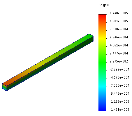

Viewing Normal Stresses
  1. In the Simulation study tree, right-click the Results folder and select Define Stress Plot .
  2. In the PropertyManager:
    1. Under Display, select SZ: Z Normal Stress in Component .
    2. Select psi in Units .
    3. Clear Deformed shape.
  3. Click the Chart Options tab.
  4. Under Position/Format, select scientific for Number Format and 3 for No of Decimals .
  5. Click PM_OK.gif.
