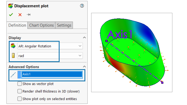

Display of Angular Deformations
You can plot angular deformation results with respect to a given axis in units of degrees or radians.
In the Displacement plot PropertyManager, select AR: Angular Rotation under Display and an axis under Advanced Options.
This is available for static and nonlinear static studies. Only studies with all solid, shell, or beam meshes support the display of angular rotations. Mixed-mesh studies are not supported. The creation of time-history plots of angular rotations for nonlinear studies is not supported.
